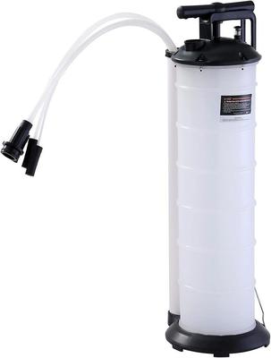

    The only specialist tools recommended for the oil change, a 32mm socket for the filter housing and a 7L hand pumped vacuum bottle to drain the engine oil... which costs around £20-£30 on Ebay, Amazon or from most decent motor factors....or you can do it the old fashioned way by crawling underneath and taking the sump plug off covering yourself and everything else in warm, black engine oil Wink
