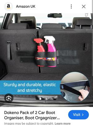

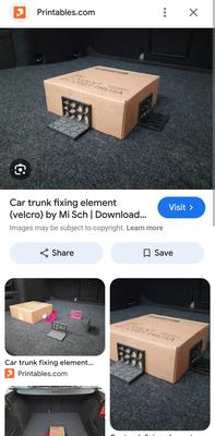

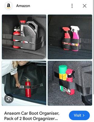

    I am trying to accomplish something like the above pictures

    Gotcha Mike.
    What I did on the D4 was to attach one side of a 4" wide Velcro strip (the hook side) to the side panels in the boot by drilling 4 small holes in the strip and pop riveting them on (you could also try self tapping screws or flat headed screws with nuts and washers), once they were loosely attached by the glue tape on the back onto where I wanted. The second strip (the hairy side) that holds the bottles and stuff can now be unvelcro'd and reattached without peeling the base strip off the panel....
    You need both sides of the velcro for it to work, you can't just stick one half of a Velcro strip onto the carpeting or side panels, or stick double sided Velcro with glue backing...no matter what that advert says. The glue...no matter how strong...won't stay stuck to the carpeting material on those side panels for more than a couple of uses at best..
    I fixed some fluid bottles and a fire extinguisher with riveted or screwed backing strips on the side panels...they were still there and working when I sold the D4. Thumbs Up

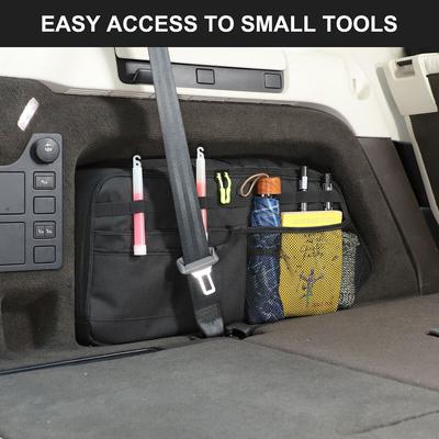

    For the D5...I got one of these things from Ebay. Which was fine until I realised I've got rear air con and the bag didn't have a recess to fit in to Rolling Eyes
    Storage Bag Linky
    I still use it for the same purpose..but now it's just shoved up against the back of the 2nd row seats...(with all the pliers and screwdrivers fitted to it)

    Yea the bag looks great and will solve half of items flying around eg. Fuel can.
    Looking at the pictures on the eBay link it looks like it sticks by glue/adhesive on velcro so not sure if that's good for temporary fix. But regardless of that price, it looks like something I am have tried to achieve with velcro only... Banging Head

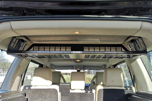

    You know what I really miss about my D4? The high level storage rack I fitted in the boot...the one that fits onto the rear grab handle mounts. I wish some enterprising Chinese dudes would reinvent one for the D5 Neutral
    Not mine...but like this one...

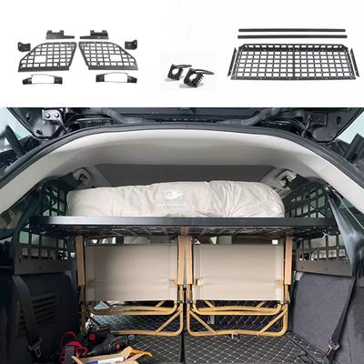

    There are some, admittedly, very tempting modular boot rack kits for the D5...but the price!! £350+ . Would have to be another Black Friday sale before I bit the bullet on one. Neutral
    Do I want one? Hell yes...
    Do I actually need one? Of course not...but I'm sure I'd find plenty of stuff to put on it. Mr. Green
    Modular boot rack linky
    __
    that looks amazing Shocked Surprised , would be great to have the rear view mirror camera while its in. but its great !
