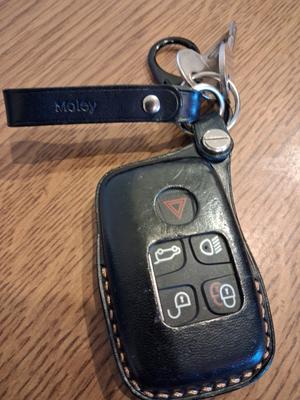

    On my main key fob, the rubber buttons were all torn and tatty so I ordered a £10 replacement case from Ebay and fit the insides (and physical key) from the original fob along with a new and decent quality battery into it.
    Got one of these nifty leather fob cases from Etsy as well...
