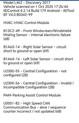

    Anybody have any views on these faults I have just found
    Posts: 876
    Most of them are fairly innocuous DTC's. Clear the faults and see if they're persistent. Things like the HVAC fault codes...does the AC and heater still work? The windscreen sensors are a common background fault. Check the park assist works...that sort of thing.
    Basically, there's nothing in there that I'd be overly worried about, clear the codes...some will be persistent...those are the ones you check physically Thumbs Up

    Cheers you have just reiterated what the dealers have said Thumbs Up

    It would be lovely...nay, it would be miraculous... to plug an IID tool into a Land Rover and have zero DTC's Laughing
