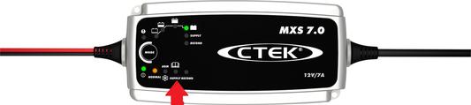

    If you have a CTEK charger, MXS 7.0 or higher, you can use it to maintain a 12v supply to the vehicle during the main battery replacement process. Simply plug the CTEK into any of the 12v auxiliary sockets (cigar lighter), use a 13 pin tow socket adapter or clip it onto the jump start terminals under the bonnet using the crocodile clips.
    Switch the CTEK charger into supply/maintenance mode then go ahead and replace the vehicle battery as normal.
