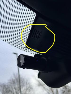

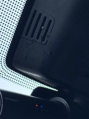

Coming back from my son's football this morning, we had a spirited drive around a roundabout at which point my lad in the front passenger seat shouts "Dad, there's water falling on me." Turns out it was coming out of this slatted area on the left-side of the rear view mirror housing.
Is this typical of the front windscreen leaks so many people report, or is this somehow linked to the air-con, and therefore something different?
Any clues appreciated, so I can decide if I need to book this in, Never had anything like it happen before.
On my previous one i did have water coming dripping out of there when i had a windscreen issue, so I'm afraid to say it looks worryingly like you may have some water coming in the windscreen seal.
Thanks for confirming - I'll call the dealer in the morning and get it booked in. I did think I was being luck to be seven years into D5 ownership, car number two, and not have had this problem!
