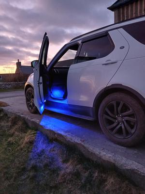

    Same...I banished the silly dim yellow puddle light bulbs on all 4 door cards and the depressing front LED footwell lights by replacing them with pretty blue LED units Cool

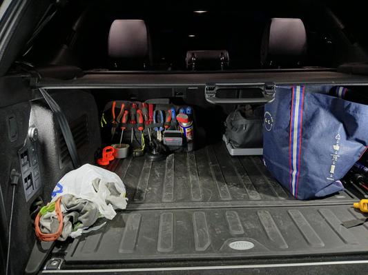

    Upgraded the 4 boot LED units to something a bit brighter too...
    Replacing the LED units/bulb holders takes about 5 minutes...plug and play stuff.
