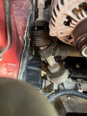

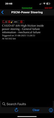

    The steering rack is the only thing I see that would overly concern me...it lists a mechanical fault rather than a general PSCM fault code...
    High friction could be due to water ingress into the steering rack, excessive wear due to lack of lubrication etc. It's not a new fault that's just spontaneously decided to crop up since you bought the D5, it's been a mechanical issue happening over a period of time before you bought it. It's only going to get worse.
    You mentioned that your D5 is still covered by a limited dealer warranty, I'd show them that fault code and get them to check and/or replace the steering rack... unless you want to add that to a future job list using your own spanners...

    Nah, that gaiter is kinda shot and has been for quite some time by the looks of it...easy to see how the water got in...
    So why didn't they spot it? Neutral

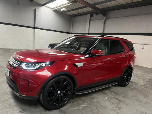

    I saw this car at Leicester and for the price, mileage , full history it is tidy apart from a few minor scuffs on the bumper and fully loaded . If I could of got a lower mileage one I would but only 2 red lux’s were available at the right price and one was private so that left this one (swombo choose the colour as it’s her car 🚗)
    Made me jealous now...I wanted a red one Laughing
    Posts: 214
    Rolling with laughter 👍🏻
    I haven’t seen many D5 tbh Loads of red disco sports though
