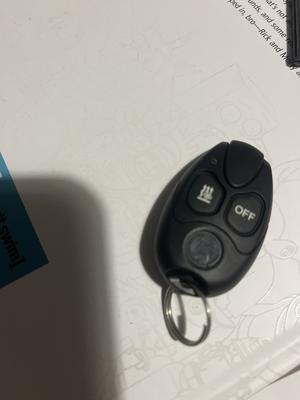

    I have also brought a Fbh remote but need help programming it to the car Whistle
    As Jon said, there's no real need for the FBH remote any more. There's an option of Climate Start on the remote app whether to use the FBH or climate control...it's a pull down menu.
    I chucked my FBH remote in the kitchen drawer when they added the option to the Remote app Thumbs Up
    Though...if you feel the need to...
    Reprogramming the Webasto T91R remote:
    1. Place batteries into the battery compartment of the transmitter.
    2. Remove fuse from the heater's fuse holder.
    3. Wait at least 5 seconds.
    4. Replace fuse in heaters fuse holder and within 5 seconds press the OFF
    button on the transmitter for at least 1 second.
    5. Learning is completed.
    A second or third hand-held transmitter can be programmed in the same manner.
    NOTE:
    The learning process can be repeated as often as necessary. The oldest transmitter will be deleted each time.
    I've no idea where the fuse is for the Webasto FBH though...I'll have a rake through the fuseboard listings.

    Has anyone got information or instructions on how to program and pair the remote to the D5?
    Posted above Dazz...I think there's a remote inline fuse on the FBH itself...if not, pull the plug out, wait 10 secs and plug it back in, then within 5 secs, press the OFF button on the remote for a couple of secs.
    That should pair the remote to the FBH.
