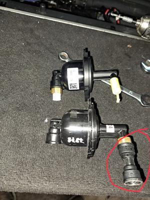

    I opened the compressor box and discovered that the black plastic connection to the pump ( expansion valve ) got broken. I've ordered a new one which I planned to install by the weekend .
    I'll keep you updated on the progress.
    Thanks for your help. Thumbs Up

    All sorted and working well. It's a pretty easy and straightforward job.
    I was able to re-use my connector without any problems. The only trick is to ensure you don't break the metal ring inside it. Mind you, the ring is fragile as it breaks at the slightest attempt to expand it. So the trick is to compress the plastic tube inside the ring at both ends and slide it out for re-use on the new expansion valve unit.
    Hope this helps someone trying to achieve same.
    I do appreciate everyone that have contributed to making this possible.
