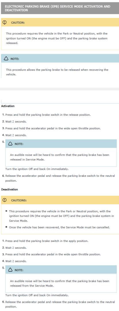

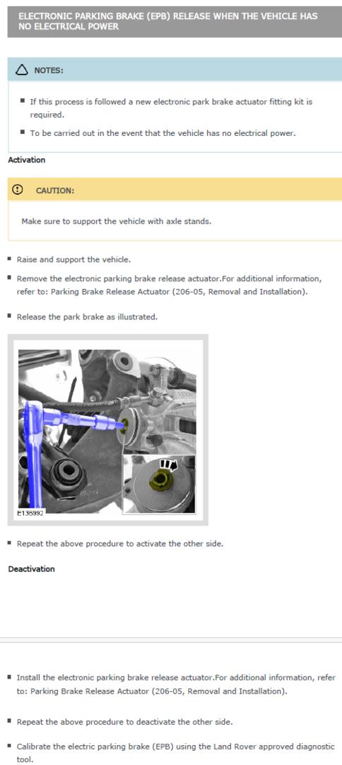

    Ok where is the hand brake release assuming under the cup holders as before ??
    Posts: 714
    No, you need to crawl under the car and work on the rear brake callipers directly.
    or if you still have electrical power....
