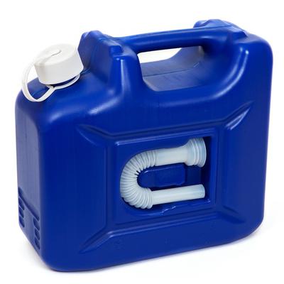

    I store my Adblue in one of these...even though it has a spout it's still easier using the 1L or 2L push on sealer type bottles you can buy from almost any filling station forecourt than lifting a heavy 10L can to top up the D5. Just keep the empty bottles, cut the bottom off so you can just up end them and click them onto the D5's filler then just top up the bottles from the cut off bottom, the neck of them seals onto the filler so there's no over spill when it burps back.
