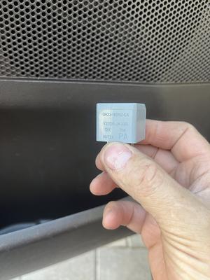

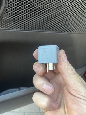

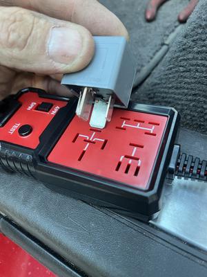

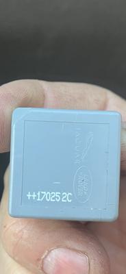

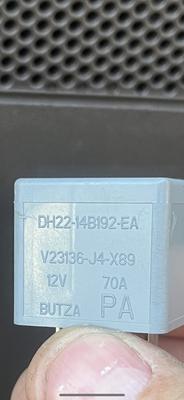

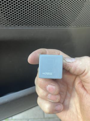

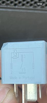

    I tried to check the relay in the passenger fuse board with my new relay tester and …..
    So i then done the old way with some wires across legs 1 & 2 to trigger it off a battery
    And my multi meter on legs 3 & 5 to see if it opens and it does.
    I checked the board where the relay came from and power was there to leg 2
    so I cleaned the the 4 spades with some wet and dry paper (240 grit) and put it back in. By the way it’s a horrid thing to take out and just as bad putting back in
    I had to use some long long nose pliers
    Once back in I touched the relay to feel the click and I did when the ignition was on

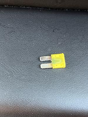

    I then check fuse 27 (5amp) and noticed how dull the contact legs were so cleaned then with wet and dry too (could have used a new fuse but couldn’t be bothered to go fetch one )
    I done the same with fuse 40 (20amp)
    I also check if power was present at the fuses and it was
    Here’s a closer look at the relay faces

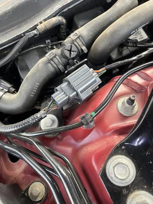

    I then went and pulled the socket from the fuel burner under the bonnet and check for voltage on the grey/ red wire and Very Happy it has power now

    So the tester didn't have the slots for that relay?..typical Neutral
    You had it sussed it anyway with the old school method. Like Jon said, the burner will only fire up on a cold engine and below 15 °c...so with the fan coming on, it looks like it's working.

    Can’t believe the one relay I need to test is an odd sized one 😂

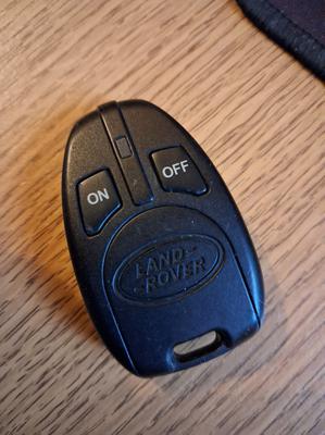

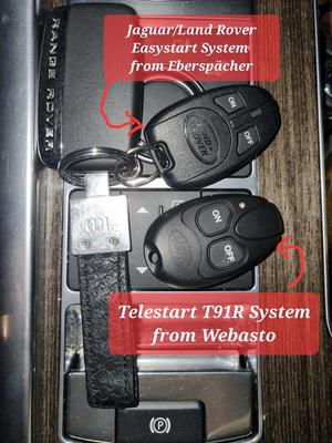

    I've been doing some digging on FBH's and which models are fitted to what JLR products. That remote fob you've got...it's the wrong type and it won't work with your FBH. That T91R type of fob is for the Webasto heaters... the later Eberspächer Easystart FBH's fitted to the D5's and later model RR's etc need the remote fob like mine.
    Here's the difference...and how you can tell which fob goes with which make of FBH.
    If you can't find one on Ebay or whatever...the Eberspächer fobs are harder to come by than the T91R Webasto ones... I'll post you mine down for nowt...I'll never use the damned thing again, not now they've added the FBH to the Remote app, so it'll just end up sitting in the kitchen drawer.
    It works fine, also got a brand new battery in it. If it needs reprogramming to your FBH (try it first), it'll probably be the same or similar method as the T91R fob...that's easily sussed out.
    Just PM me your address etc and I'll stick it in the post Thumbs Up

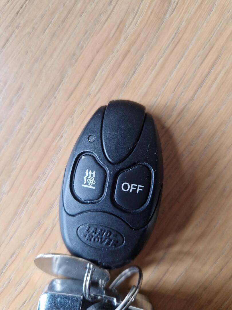

    Ah, but,
    This is mine
    From a MY22 D300, and the one from my previous MY19 SD6 looked exactly the same....

    I know that Dazz has exactly the same FBH as mine though...I checked the label on mine and it's the same as the one he posted up a few pages back. Eberspächer Easystart.
    Should be fine...fingers crossed etc Whistle

    If I remember correctly, didn't the D4/D3 have a receiver module for the remote somewhere in a rear quarter? Surely the remote needs to match the receiver and the receiver needs to be working correctly as well?
    MY2026 D5 Metropolitan D350 - on order......
    MY2022 D5 HSE D300 - current, MY2019 D5 HSE SD6 - sold
    Posts: 463
    The reprogramming of new or replacement remote fobs is the same on all Webasto heaters, I know from replacing my T91R fob for the D4 after I accidentally ran it over and squished it Rolling Eyes
    I just bought a generic replacement Webasto T91R style fob from Ebay and paired it up with my original Webasto heater.
    Since the fobs are electronically generic in manufacture, I suspect the Eberspächer fobs will be the same or similar process as the T91R for pairing to any individual FBH/receiver.
    It's just an ultrasonic remote on a certain frequency...so the same process as pairing up a new/replacement remote for a SKY Q box or TV etc.
