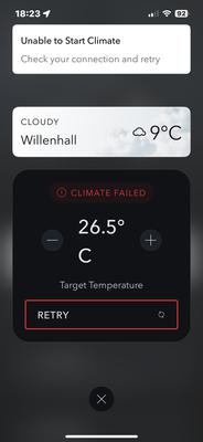

    I tried connecting the remote again… no joy but I did notice when sat in the car and requesting on the app pressing the fan I could hear a relay click then I’d get this message
    But the cars timed climate is working

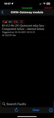

    It makes me think more about that fault Code

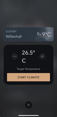

    Right , today I used the app to start the Fbh but it’s not the same drop down menu as moles
    On the photo you can see the small fan on the first page, I clicked that then it showed me this option
    Once I pressed start it then initiates and then told me at started Hu Ra Very Happy

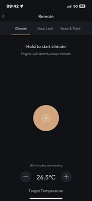

    For me to start the engine I have to click remote
    Then climate to show this

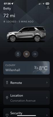

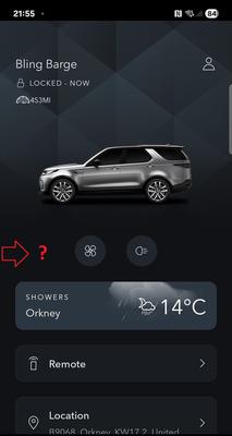

    I noticed you've got 1 more icon on the main page of the app than I have, the one on the left next to the little fan icon.
    What is it and why haven't I got one? Laughing
