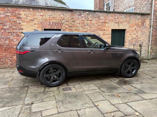

    20" Defender Wheels on Discovery 5 D300 Metropolitan
    I've just fitted a set of 20" Defender 5098 style wheels (cost £370 inc good tyres from eBay!) on my '23 plate Discovery D300 - which had 285/40/R22 originally. The tyres that are now on are 255/60/R20 .... technically 255/55/R20 are a better match as diameter is an almost exact swap (but the 60 profile ones I have on seem fine). It's certainly more comfortable and quieter, and opens up way more tyre options like General Grabber AT3 which I'll probably fit once my Pirelli Scorpion Zeros have expired. These defender alloys are available for very little money for some reason and plenty about on eBay. Highly recommend the swap for either comfort or off-road ability.
