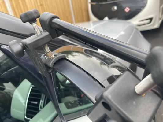

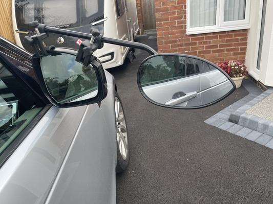

    Posts: 96
    This is the newer model Milenco Aero just fitted roughly to get you a picture. Note the arched foot which gives a better grip. I had the older type with the flat feet and one fell of last year hence the new ones 😂.

    I think I’ve got the same but the clamps I’ve got are crap with the mirror body curve
    I need some curved feet like the previous post
