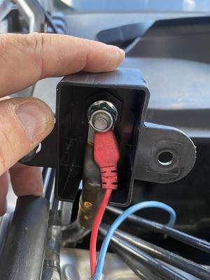

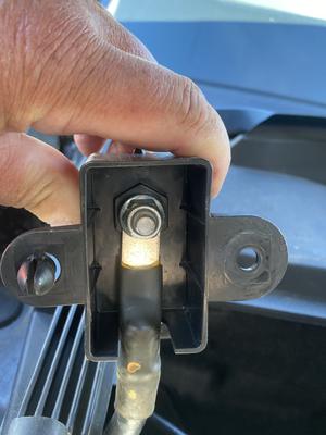

    Good news, if you release the 10mm bolt that secures the box, the underneath of that black box looks like this:
    I attached to the 13mm nut.
    Similarly with the earth post.
    The two 10mm’s ( the negative terminal is also 10mm ) are into captivated nuts so it’s really straight forward.

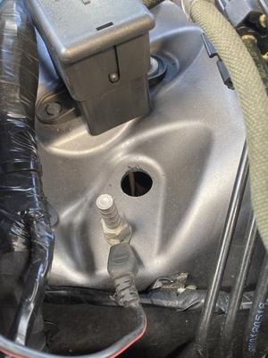

    I just need to find a suitable location to run my Ctek comfort connector to and we should be in business.
    A quick look indicates I’ll need to grind a bit of the grill away to allow access to the connector which isn’t ideal.🤔
    Incidentally, not a clue what the torque values are of the two battery lugs, I just went with two white knuckles when putting them back.😉

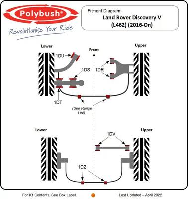

    One thing that's on my wish list is fitting polybushes once the rubber suspension bushes get worn and need replacing....Not cheap at around £600 for a full set but well worth it in the long run as it's waving goodbye to ever having MOT advisories for 'slightly worn' swing arm bushes.
