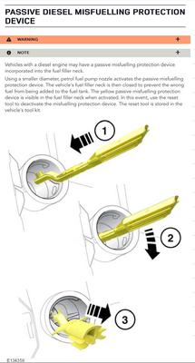

    If you can see that yellow barrier in the fuel filler with a little book logo on it, you'll need a misfuel reset tool to reset it. They're about a fiver on Amazon or Ebay, or pop into a local motor factors... or even Halfords... and pick one up.
    https://www.amazon.co.uk/Discovery-Diesel-...B0FGXYPJYH
    It's a Disco 4 video...but it's the same process on every make of car using the same tool.

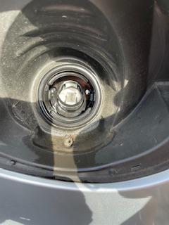

    I did look down the pipe once I had figured how to open the automatic misfuel valve. There is nothing in there! I can’t see a way to get a good picture but it looks clear, I can see the bend in the pipe which is further down than a passive misfuel valve would be…..

    Did you use a misfuel tool to retract the misfuel flap or did you use a screwdriver or something? You might need to set off the active flap again and use a proper tool to retract it...

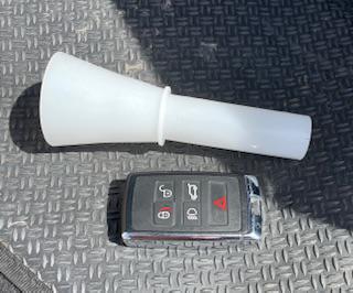

    Mine comes with this (key for scale)
    It fits in the filler and opens the automatic misfuel valve which looks like this:

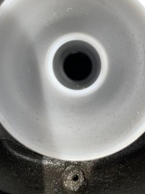

    With the white device fitted I can see the pipe to the first bend but can’t get a picture of that 😂.

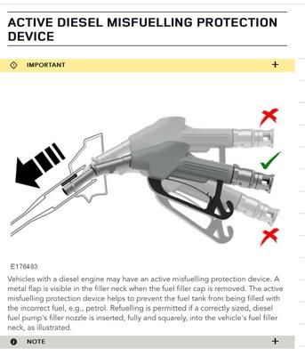

    From the iGuide there is supposed to be two types but who knows…..

    My filler neck looks exactly the same...but you shouldn't need the plastic funnel to refuel...which might be the issue if that plastic collar is blocking the vent tube. Try filling up without using the plastic funnel, it should be fine...that metal valve you can see just moves out of the way when you stick the fuel pump nozzle in.

    Sorry, misleading you. I don’t use it to fill up, I only used it to open the valve to look inside, only just found it when searching for a yellow tool ….. The valve opens just fine when you stick the right size nozzle in at the fuel pump
