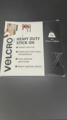

    Hey guys, a bit weird question but hey hou....
    has anyone ever managed to get a velcro that sticks to the liner/ carpet or side walls of disco boot? I have the 25MY and have bought and tried 6 different types, including some high quality velcro made by velcro to some cheap ones, but nothing holds in place, not even tiny bit...
    Just want to hold some items in place or on the wall so it doesn't move and hit the sides of boot at every single corner...
    Can you post a link of picture or something if you managed to find one?
    Thanks a lot

    Are you sticking the Velcro to both pieces that you wish to hold or just one?
    Confused.🫤

    I am trying to accomplish something like the above pictures
    Gotcha Mike.
    What I did on the D4 was to attach one side of a 4" wide Velcro strip (the hook side) to the side panels in the boot by drilling 4 small holes in the strip and pop riveting them on (you could also try self tapping screws or flat headed screws with nuts and washers), once they were loosely attached by the glue tape on the back onto where I wanted. The second strip (the hairy side) that holds the bottles and stuff can now be unvelcro'd and reattached without peeling the base strip off the panel....
    You need both sides of the velcro for it to work, you can't just stick one half of a Velcro strip onto the carpeting or side panels, or stick double sided Velcro with glue backing...no matter what that advert says. The glue...no matter how strong...won't stay stuck to the carpeting material on those side panels for more than a couple of uses at best..
    I fixed some fluid bottles and a fire extinguisher with riveted or screwed backing strips on the side panels...they were still there and working when I sold the D4. Thumbs Up
