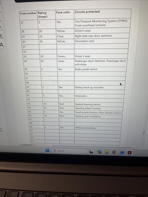

    Just looking through fuses and locations and found this in passenger compartment 41. 5amp telematic
    Could that be to do with the Fbh
    Or even 56. 10amp heating and ventilation

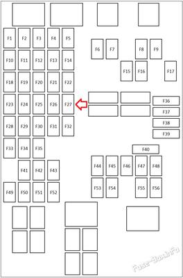

    Nope, it's definitely Fuse 27 in the glovebox fuseboard. That one (5 amp) fuse covers the FBH, TPMS and the roof console.
    Fuse location diagrams Linky...(Just scroll down to #27 in the fuse listing). I know it doesn't mention a 2017 D5 having a FBH although it lists it under 2018...but I've got one, so have you. It'll be listed under F27 on the fusebox lid diagram, I can guarantee it, Wink

    Thanks mole
    You are correct mate

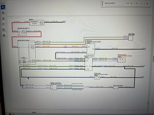

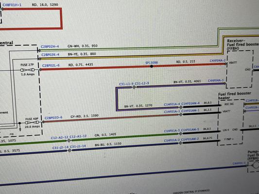

    On the wire diagram it labels 27

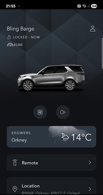

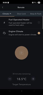

    From the main page on the Remote app. press 'Remote'. On the Remote screen, there's a little upside down V symbol next to 'Climate'...press that and the option for 'Fuel Operated Heater' or 'Engine Climate' is there Wink
    I'd show a screenshot but I haven't worked out how to screenshot my phone screen yet Laughing
    I still haven’t found this option
    Posts: 817
    It's on the wee drop down menu under climate once you get to the remote screen...
    Posts: 704
    I presume that the option won't be there on vehicles that don't have the FBH option fitted.
