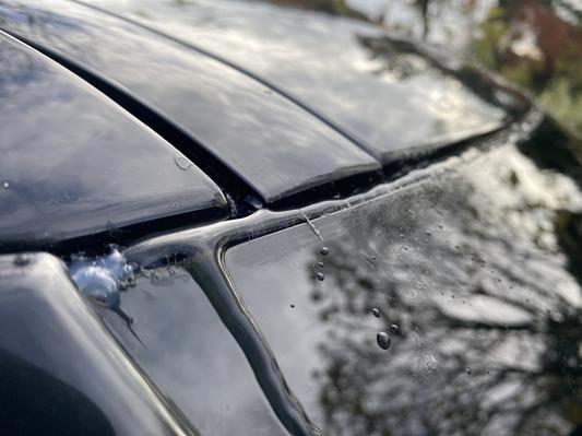

    My first leak was also running down the windscreen as well as dripping in my lap from the puddle behind the headliner. National windscreen showed me the primer problem on the glass…it was lifting and the attached sealant with it! I then had a period of 2-3 years with no leaks.
    This time there is no water sign on the windscreen inside!
    So I started to think this in another problem and (as you say) water will find the lowest point where ever it enters the vehicle.
    To rule out the “sealant to glassl interface I created my own Silicone Valley Laughing
    I placed beads of silicone in the “gully” every 12” right across the windscreen and trickled water onto the roof from the far/opposite side to the eventually drip point. Kitchen towel was liberally stuck up inside the headliner in the puddle area.
    Satisfied the ingress wasn’t in the first position I removed the first silicone “dam” . I did this for over an hour or more running water then removing each dam in turn and letting it flood to the next one.
    No water got through onto the kitchen towel even when the last dam was right on the edge of the windscreen.
    I am therefore convinced the glass is stuck to the seal/bed and the water must be getting round the back on the bodywork side.

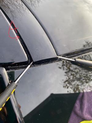

    I then ran water into the gap in the black trim section position A and water immediately wet the kitchen towel. So the point of ingress is somewhere under this trim.
    And I now need some help from any listening in expert to know if these panels should be stuck and sealed to the roof completely, or if water is expected to track underneath.
    Presumably, this strip covers the roof bar access points and I am wondering if water can get through the recess for the roof bars? Not having fitted any or seen how they attach I don’t know if there could be something wrong in that area or if the water is passing through and meeting a gap between the body shell and the JLR bonded windscreen seal/bed?
    Help anyone?

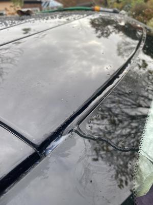

    Might as well add the reply on this thread as it’s more relevant…
    You would not believe it! Or maybe we should being JLR.
    Under the leading edge of the black trim the rubber skirt was cut short (or damaged) on one side.
    The real howler was the windscreen rubber seal was pulled straight rather than following the curve of the body leaving a gap of about 3mm between roof and seal. And of course the gap perfectly coincides with the missing bit of rubber skirt on the trim.
    I’m guessing water just might go down there Whistle
    Having dried and cleaned there and heated it all with a hair dryer, I scraped some of the flowable sealant into the gap and having left it for a few flowable minutes, released the trim to press in place.
    Heaven knows if it fixed it.
    On reflection the one thing I didn’t do was to actually pour some water directly in the gap to see if it disappeared “indoors” but I was losing light and I wanted it dry to reseal.
    So I will just have to wait with bated breath (as I am sure all you readers will be doing Rolling with laughter ) for the next episode of “hold back the waters”.
