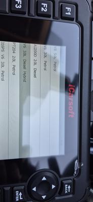

    I got the cr pro +, It won't read my chassis number to find the car. So i have to find land rover discovery 2017 on, then it comes up with the variants, (petrol, diesel ect), i have to select diesel hybrid. Then it finds my chassis number. Seems strange that i have to select diesel hybrid.

    Yeah, I had to select 'Land Rover' from the huge list of car manufacturers then select 'auto-read VIN' on the CR Max to get it to identify the Bling Barge....Once it had done that though, it was fine.
    I suppose it's a small price to pay through using a multi-car generic OBD2 scanner though...it's still an extremely proficient professional level tool at the end of the day by way of functionality...especially on a Land Rover.
