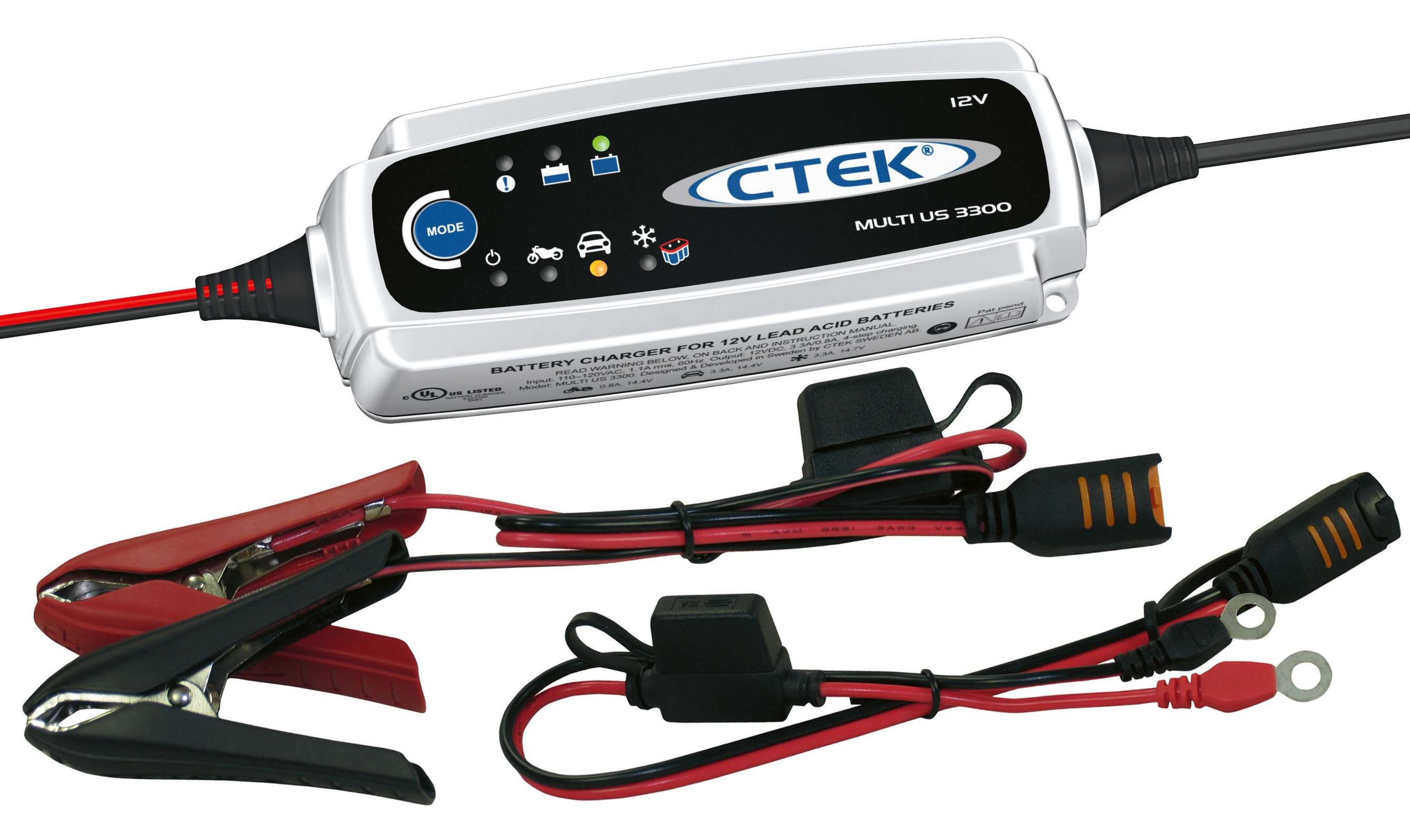

    It's a battery charging socket for the CTEK range of chargers. Not cheap but you get what you pay for.
    Review here http://www.autoexpress.co.uk/accessories-t...ger-review
    The orange and black thing is the CTEK connector that is on all of their chargers.
    Click image to enlarge
    But the question remains - what are you powering that means you need to externally charge your battery often enough that adding a connector is worthwhile? Confused
    My car has two dash cams fitted one in the back one in the front and is set for parking recording. The car does not get used or long periods of time so this is just to fit the trickle charger if needed
