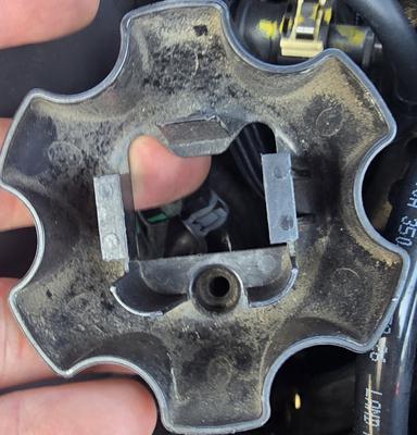

    I'd still say it's more than likely to be related to the PCV, clogged or inop...he also has a loose, broken component he found rattling around the left hand side of the engine bay (from his other recent post on this forum). It has what looks like a broken or severed rubber breather pipe attached. I still haven't been able to identify what part it is or where it's originally come from.
    I initially thought 'broken air suspension part', due to it's appearance and where he discovered it...now I'm not so sure due to the excessive blow-by issue. It could be engine, fuel or PCV related, I've really no idea yet...

    Did you ever suss out what the spare loose bit was or where it came from?

    That sounds like a decent resolution. I hope the dealer isn't leaving you carrying the can for it though...You could also show the dealer the photo of that loose fuel filter vent housing and see if there's a spring clip missing Thumbs Up
