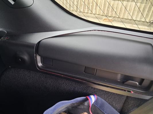

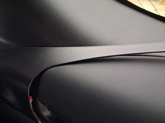

    Anyway, I went about trying to install the thing, since even with no installation guide, it's not rocket science...there were a few fitting issues... to say the least.
    The bottom mounting plates didn't fit around the C pillar, the top grab handle mounts also didn't fit as the original T30 torx bolts reused in the installation weren't long enough to refit the grab handles along with the mounting brackets.
    I'm at the stage of just returning the damned thing for a refund. I could re-engineer the bottom mounting brackets to make them fit...since a bit of heating and bending isn't rocket science either...and found some longer T30 torx bolts for the grab handle brackets...but for the asking price of £350...I'm reluctant to do the manufacturer's job for them.
    Pics below showing the bottom mounting bracket...straight edge where it should have been curved or moulded to fit around the C pillar. The brackets blocked off the side cubby box lids and refused to seat properly despite what it showed in their advertisement. Didn't take any pics of the grab handle top mounts...I was at the swearing and tool throwing stage by then Censored
    Honest advice? If your D5 doesn't have rear air con, it'll fit just fine and dandy...but steer clear of this brand of modular boot kit if you have rear AC fitted in your D5... unless you have some basic engineering skills and tools and are prepared to use them...it doesn't fit rear AC models out of the box. Neutral

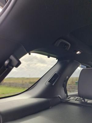

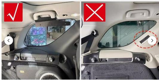

    The manufacturers/suppliers have since added this image to the advertisement...seemingly, if you have rear aircon with the rear quarterlight vents on the C pillar, the kit (as supplied) doesn't fit. Pity that image was absent and there was no mention of rear aircon incompatibility on the original ad, it would have saved me wasting my time and money Censored
    The Bling Barge has the 3 zone aircon with the rear quarterlight vents, the internal plastic moulding on the C pillar is different...saying that, the image on the right above with the big red X shows a totally different lower mounting bracket that (apparently) does fit with the C pillar vents...unless that image has been photoshopped, why wasn't I sent those ones with the kit instead?
