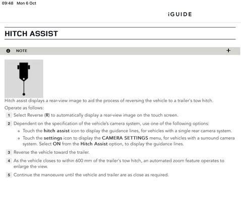

Hi all. I have recently upgrade to a 69 plate D5 from a crankshaft fail D4. There is one thing the 5 has not got that I could do with if possible. On the D4 in reverse I could tap the screen and change the reverse camera to a single yellow line to pick up the tow hitch. Is this possible on the 5 or not. If so is it a gap unit to get it.
Also I have heard about tow assist how do I know if I have it or not.

Thankyou I will have a look at that bit

Hi. Just checked and ye the camera settings bring it on. Superb. Thankyou for that. I have heard from another D5’owner that you can tell the car what you are towing and weight. Like twin axle caravan
