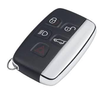

    Posts: 198
    Can it program a spare key
    I’ve read Landrover has locked it ????

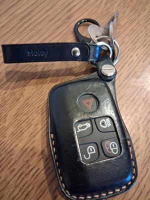

    Posts: 733
    Worked on mine, I programmed a spare fob I bought from Ebay with it...but we've both got the old style D4 type keyfobs, LR changed the fobs to Ultra Wide Band in 2018 to combat the surge in relay thefts. I'd have to check if the G4 does the new style UWB keyfobs or not.
    Can't see why not since it's all done via the BCM...but I haven't checked if an official security update on the later model D5's software may have changed it.
    Posts: 198
    The G3 when I click the sub menu to add a new key I go through the motions continue continue continue on the final one which is would you like to proceed? Continue and it takes me back to the start of the menu 🤷🏻‍♂️ is it because I’ve got the G3 it won’t allow me to do this
    That key is the same as mine but it says landrover
    Posts: 733
    Same keyfob as mine...
    Posts: 198
    👍🏻 thought so
