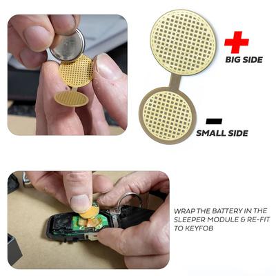

    Just as a quick addendum to this sleeping battery topic, the guys at PowerfulUK are selling this sleeping battery conversion module for pre 2018 non UWB key fobs.
    It differs from the individual sleeping batteries available from the likes of Amazon or Ebay in that this small electronic module allows you to use any standard CR2025/CR2032 fob battery and convert it to the sleeping battery tech. It means you only have to buy this once and simply re-use it when you replace the fob battery...rather than constantly buying new replacement sleeping batteries at £60 a piece. The kit also comes with a Faraday pouch.
    I'd also suggest using 3v CR2025 batteries with the sleeping module...since the diameter is the same as the 3v CR2032's. CR denotes lithium coin type. 20 being the diameter. 25 or 32 etc being the thickness. The slightly thinner CR2025 batteries + the sleeping module will be an easier fit in the fob.
    Simon at PowerfulUK also did an explaination video (in the link above) on fitting the gadget and how the sleeping battery tech works.
    Retails at £57 per unit (no battery included) with free UK shipping from PowerfulUK with complimentary Faraday pouch.
