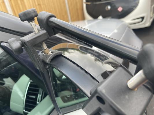

    See this thread, as quoted there, I use Milenco Aero fitted to the top of the mirror which folds without any issues.
    This one was fitted loosely just to get the photo.

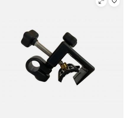

    Member Since: 16 Mar 2023
    Posts: 75
    https://www.ebay.co.uk/itm/223183728218?_s...R66Hkv3CZg
    As mentioned, you can only get away with using 2 of these pads, 1 on each side, so don’t know why they sell them in a 4 pack.

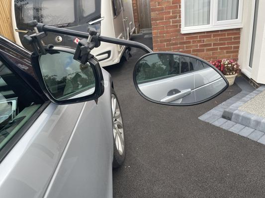

  • Beno2
    Location: South East (Essex)
    Posts: 67
    Just done a 250 mile caravan journey without any towing mirrors. This was the first time towing with the D5 and it was OK.
    Posts: 538
    I am reminded of Crocodile Dundees assessment of grub bush tucker …
    ” you can live on it, but it tastes like sh*t”
    I have very tight right angle approach to my property and I’ve tried it without big towing mirrors and ended up dropping the window and leaning out. Similarly they give a so much clearer perspective when navigating country roads and reversing onto camping pitches. (Especially some of the sites in Europe we visited)
    Yes it’s perfectly doable without towing mirrors providing you can meet the legal requirement, but considering the cost of the vehicle and trailer you want to protect, a pair of extension mirrors is a small price to add.
