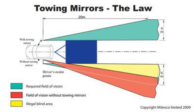

    I have very tight right angle approach to my property and I’ve tried it without big towing mirrors and ended up dropping the window and leaning out. Similarly they give a so much clearer perspective when navigating country roads and reversing onto camping pitches. (Especially some of the sites in Europe we visited)
    Yes it’s perfectly doable without towing mirrors providing you can meet the legal requirement, but considering the cost of the vehicle and trailer you want to protect, a pair of extension mirrors is a small price to add.
