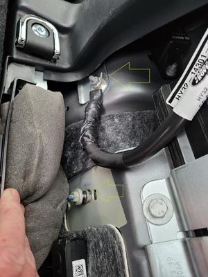

    I agree with Jon, sounds like a dodgy main battery earth.. If it is, you can temporarily relocate it easily enough...there's 1 or 2 alternative earth locations in the boot...
    Pic showing original faulty earth stud (centre) and an alternative earthing point (my arrows aren't very clear)

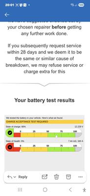

    Checked the earth strap and it has been moved. Had a report from the AA come through overnight that now says that the battery is at 66%. (they said it was ok yesterday), I have checked with my tester this morning as it's been damp and cold overnight, and it is showing as 22% and no longer serviceable. CCA should be 920A, and it is putting out 433A. Had a look at the battery and it is the original Land Rover battery, so 7 years isn't doing too bad i suppose. Alternator still checked out ok on my tester. So looks like a new battery time.
