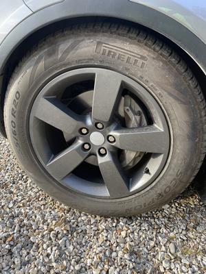

    Pic as requested..... Sorry it took a while!
    D300 HSE Commercial - Previously 90HT, D4, D4, D4, D2, D1 (3 door V8!)
  • JBFUK
    Member Since: 25 Apr 2022
    Location: South East
    Posts: 118
    Interesting, those are a size up from the standard disco tyres - similar to the 285/45/22 mentioned at the start of this thread or 275/55/20. I’ve done quite a bit of research on wheel/tyre sizes, offsets etc. I’m now running 20’s. I’ll make a post about it when I get a bit of time.
