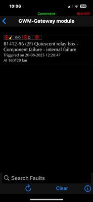

    Ok I’ve just found this
    I had this fault code is this related to this ??
    Posts: 889
    Certainly looks like being a culprit and it's a physical fault, not just an error code. I take it it's a permanent fault and won't clear when you clear the DTC's?
    If the FBH is knackered...it's another bit on the list for warranty replacement I reckon

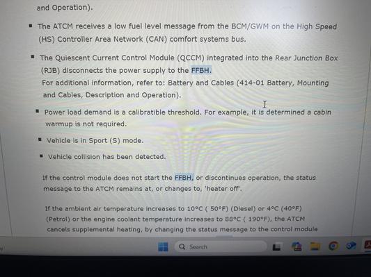

    I just found this quick on the tinterweb

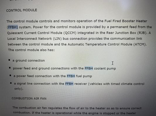

    Have found this also
    I need to find the wiring diagram to check if power is there

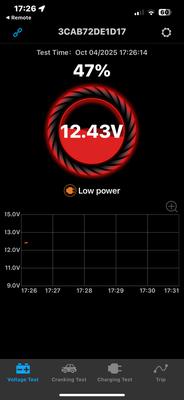

    Cars been started 2-3 times trying this Fbh
    And it’s like this now
    Posts: 889
    The percentage looks bad dropping from 60% to 47%...but from the first screenshot you posted at 60%, the battery voltage was 12.5v. After 3 starts, it's dropped 0.7v to 12.43v...which isn't that bad.
    The percentage reading just makes it look worse Wink
