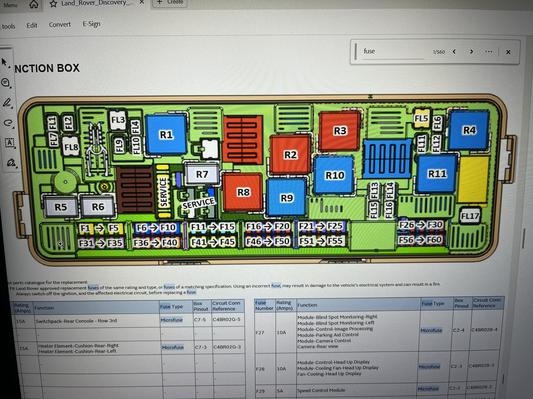

    Is the junction box central the fuse board in the boot ?

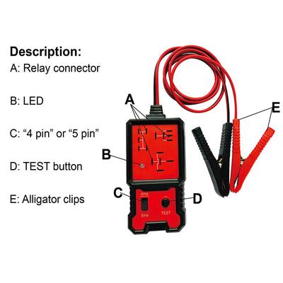

    So it's covered by a relay within the LINBUS. Might be worth sticking that relay on a tester.
    A tenner on Ebay or Amazon...
    I've had one for years in the toolbox... as much as it's hardly ever been used in anger, it's handy for checking starter and headlight relays and the like. It's a bit easier and quicker than the old school method of running a 12v supply through the pins on a relay and listening to hear if it clicks.
    Better to have it and not need it rather than t'other way around Thumbs Up

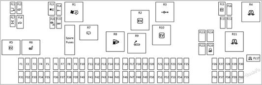

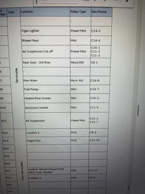

    What relay though ?? Which one
    That relay in the diagram is in the rear junction box in the right side of the boot. Relay 31p according to the wiring diagram you showed.
    The fusebox diagram shows it as R1 on the diagram though...one with the little fan on it.
    It says air suspension
    It's the blue one...R1. In the diagram I posted it has a little fan on it.
    I might try swooping it with R9 rear screen to see if it does work
    Your diagram show a cigarette but mine labels heated rear screen. 🤷🏻‍♂️
    Ordered Thumbs Up
