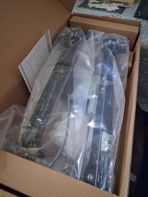

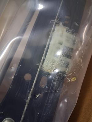

    New regulator got here this morning. On opening the box, I noticed one thing that's been absent from any of the other regulators on the Bling Barge...including the replacement I fitted already on to the LF passenger door earlier this year...the cable on this one has been pre-greased and the unit sealed in plastic.
    The OE replacement I got for the LF passenger door just came loose in a box with no greased cables or plastic packing.
    The cables not being greased on the OE regulators when they're fitted at the factory is why they rust and eventually snap...I coated the cable on the one I've already fitted with lithium grease as a simple preventative measure. So, it's nice to see a cheap Ebay replacement already having this done...
    I'm impressed with the overall quality of this regulator...so much so, I've ordered spares for the LR passenger door and the drivers door to stick on the spares shelf in the garage for when the remaining OE ones eventually do break.
    Total cost of all 3 regulators from the parts supplier in Selby (link in my original post), £182 with free postage... that's around £50 less than one OE replacement regulator from Land Rover Rolling Eyes
    I'll fit the new regulator when the weather calms down a bit...it's blowing a gale and lashing with rain again. Yawn
    New regulator fitted this morning. Straight out and in job, took around 20 minutes. Another plus point over the OE regulator, it hadn't been packed fully extended and the glass retaining brackets were set half way up the runners... which makes fitting the glass into the regulator frame so much easier. A small thing... but a very welcome one Wink
    Recalibrated the windows so the Remote app would stop moaning about them being open Rolling Eyes
    As a small bonus...found a freebie pair of woolly work gloves in the bottom of the box the regulator came in. With the cables and runners being pre-greased, makes it less of a sticky mess handling the regulator when fitting I suppose.
    In direct comparison, having already fitted an OE regulator to the LF passenger door, this regulator was the same if not better than OE quality overall... from the materials, the build quality, the greased cables, the actual fit and the free gloves.
    Definitely worth the buy at £70. Gets a big Thumbs Up from me.
