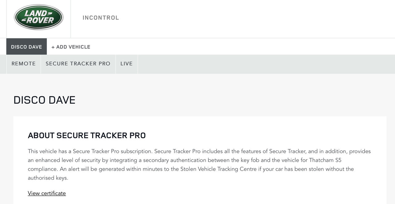

    The standard 'Secure Tracker' has recently been downgraded by Thatcham to S7 (not insurance approved) level because it can be blocked/jammed within a matter of seconds and offers no protection against cloned keys. 'Secure Tracker Pro' is the new 'optional' service (it costs around £180 a year) and is S5 (insurance approved) level. Secure Tracker Pro has an extra chip in the keyfob which validates the key to the car when the car is being started, if the chip isn't identified it alerts Tracker HQ that your car has been started with a cloned key. On the remote app I also have “Guardian mode” switched on which alerts me as soon as the door is opened when I'm not with the car.
    It's a bit of a rock and a hard place LR are in, they obviously don't want to be too blatant that their standard systems are so Censored -poor, but at the same time I personally think they don't do enough to advertise the merits of Secure Tracker Pro. For the sake of £180 a year to have a decent tracker, it's a no brainer IMO.
    This is what the STP says on my InControl...
