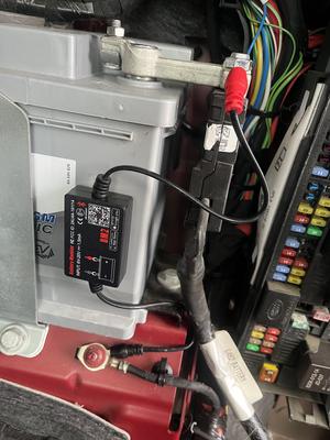

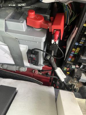

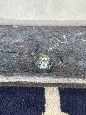

    Hi guys just thought I’d share the battery monitor system I’ve just fitted and to be honest for the price and work to fit it’s a nice little gadget
    The bolt to secure to the positive was a 8mm x8mm long bolt
    13mm socket for the 8mm bolt
    10mm socket to undo the neutral earth point

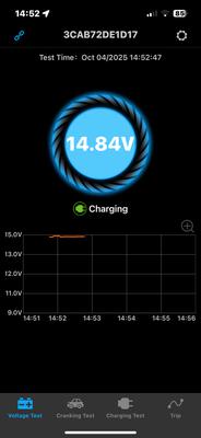

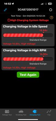

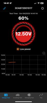

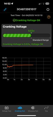

    Just abit of feed back with the monitor with some screen shots
    That’s 15 days view
    7 day view
